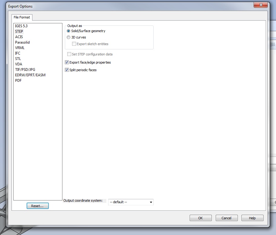

The only option I have used is when you click "Save as" and then click the "Options" button it pulls up the attached dialog box. At the bottom, you can select the coordinate system you have assigned. Let me know if this is what you are talking about.

Yes, that I am talking about. How to do that coordinate system selection by VBA. We have to export Step where origin and axis are located to specific point. This helps to locate imported Step in another application.
