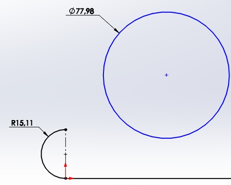

As you can see when I make dimensions it gives me radius option. But I want to see it in diameter. Is there any option for this as default?

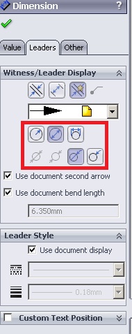

Hi Ama,
You can perform this by choosing the Leader Style for the Dimension. To do So:
1.Draw a Arc Or Circle
2.Go for Smart Dimension and select the Arc or circle.
3.Then Go to Leaders option and select the Desired One. FYR,I have attached the screenshot.
Thanks & Regards ,
N.Vignesh
Ama,
You can right click on a Radius dimension & scroll down to choose "Display as Diameter". If it's not visible you might need to "Customize" your menu & add it.
Not sure if there is a way to always show as a diameter by default. Somone on the Forum may be able to write a Macro to do this.
