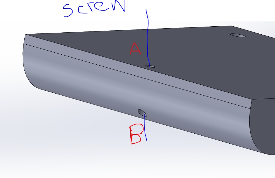

Hello, I have an object with filleted curved surface at the bottom. I want to attach it to another object above it (on the surface labelled A). I want to join the two objects using screw. The problem is that as the screw head and the nut are larger than the hole, how do I fit/hide a screw head or the nut at B? Any suggestion with photo for easy understanding is appreciated. Thank you.

Not sure if this what you're looking for.
comment imagecomment imagecomment imagecomment image

Looks good. Could you please let me know how to do it?

find the attached part file and take a look at it peter.
