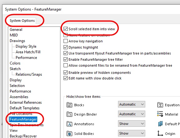

One of the most useful settings when working with assemblies is Scroll Selected Item into View.
It is also the biggest factor of slow-down when selecting multiple components in a large assembly. Even in Large Design Review mode, the user productivity is destroyed if this setting is on.
I have a macro that turns this setting on or off, as the user requires, but macros do not seem to work in LDR mode.

What error do you have? I can run the macro just fine in the LDR mode. The one below toggles off this option and just for test displays a message box.
Dim swApp As SldWorks.SldWorks
Sub main()
swApp.SetUserPreferenceToggle swUserPreferenceToggle_e.swFeatureManagerEnsureVisible, False
swApp.SendMsgToUser "Test"
End Sub
Could you please try it from your end?
