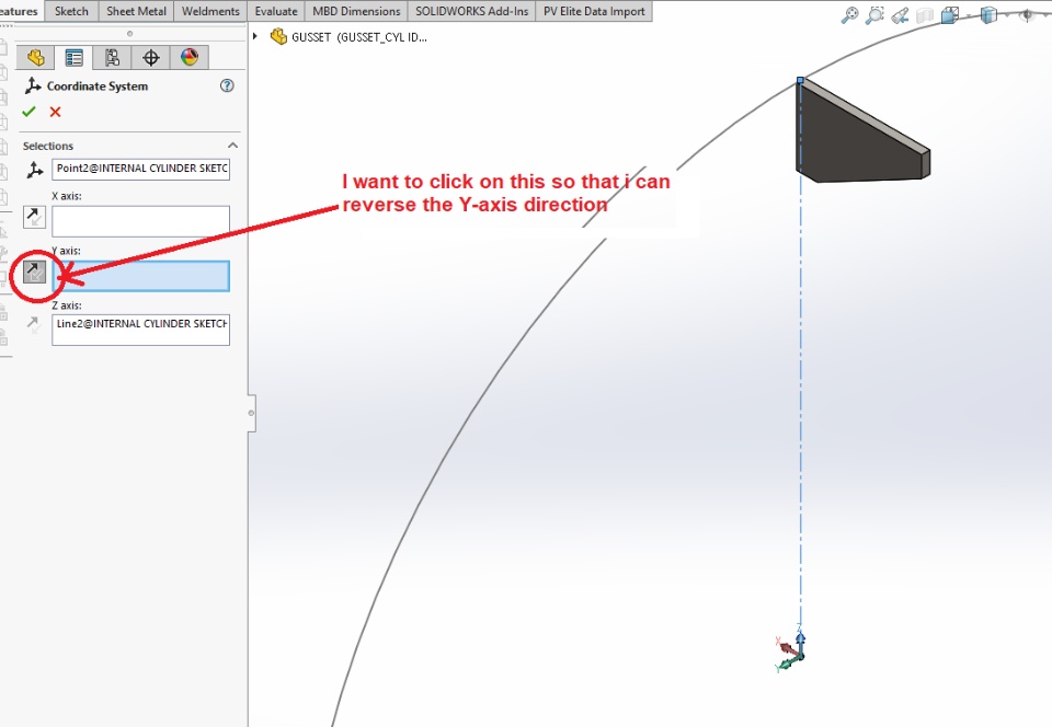

I am having a solidwork part document opened which has coordinate system (refer attached picture). I wan to reverse Y-direction of selected coordinate system.
I am using following code but its not working can anybody help me?
Code:-
Dim Coordinate_Sys_name As string="Coord1"
boolstatus = oDoc.Extension.SelectByID2(Coordinate_Sys_name, "COORDSYS", 0, 0, 0, False, 0, Nothing, 0)
swFeat = oDoc.SelectionManager.GetSelectedObject6(1, -1)
swCoordSys = swFeat.GetDefinition
swCoordSys.YFlipped = True
oDoc.EditRebuild3()
