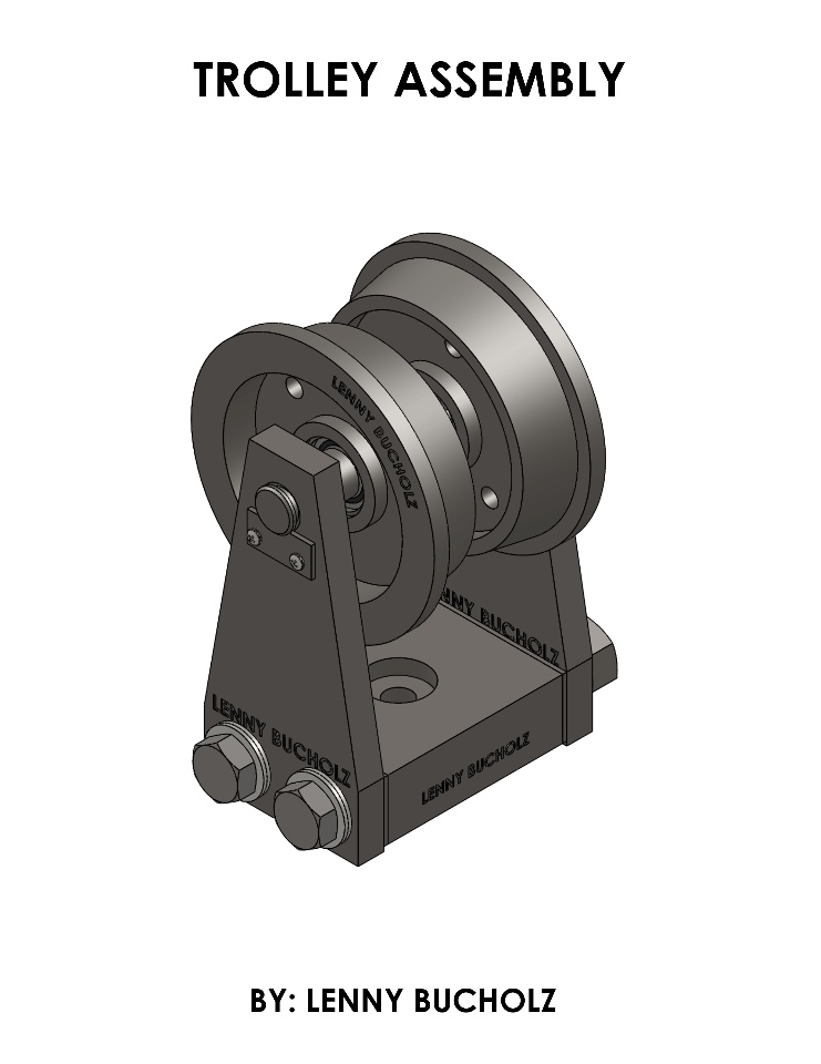

There are a couple of ways, teach this to the students.
One is how Paul said above and 2 is when the students don't follow dirrection and did all their work in single drawings.
if you select the view and control C the go to the new drawing and control V it copies the view and the dims....done.
here is a pdf from my class, one drawing file 11 sheets with assembly and parts.
Message was edited by: Lenny Bucholz
name is on there to stop cheaters
comment imagecomment image
