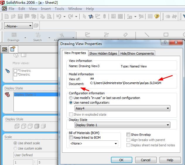

How to Replace model reference in view on drawing
Follow code , don't change  View reference Model name.
Private Sub ll()
   Dim SwApp As SldWorks.SldWorks, SwModel As ModelDoc2, oModel As ModelDoc2
       Set SwApp = Application.SldWorks
       Set SwModel = SwApp.ActiveDoc
   Dim SwSelMgr As SelectionMgr
       Set SwSelMgr = SwModel.SelectionManager
   Dim SwView As View
       Set SwView = SwSelMgr.GetSelectedObject5(1)
       Debug.Print SwView.Name,
       Set oModel = SwView.ReferencedDocument
       Debug.Print oModel.GetPathName
       tmp = SwView.LoadModel
       Stop
End Sub

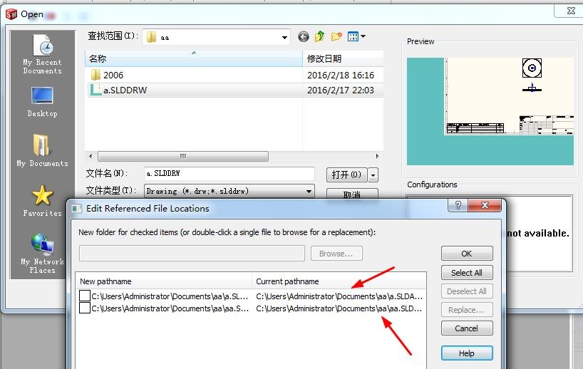

2014 SOLIDWORKS Help - Replacing Model in a Drawing View  http://help.solidworks.com/2014/English/SolidWorks/sldworks/t_replace_model_in_view.htm
Manual method
To edit part location:
Click File, Open, References, or click File, Save As, References.
In the New pathname list, select a path or filename that you want to edit , or click Select All.
You can edit the path or filename using one of the following methods:
Select a list entry by double-clicking. Browse to a new folder or type a new name in the Open dialog box, then click Open.
Select the check box for a list entry and click Browse to change to a new drive or directory path. The new drive or path appears in the New folder box.
Click Replace and enter a word to find and a word to replace with. (For example, change "\\samples" to "\\archive" to move one or all part files to the archive directory.) Click the Match case check box if the case is significant in the search.
