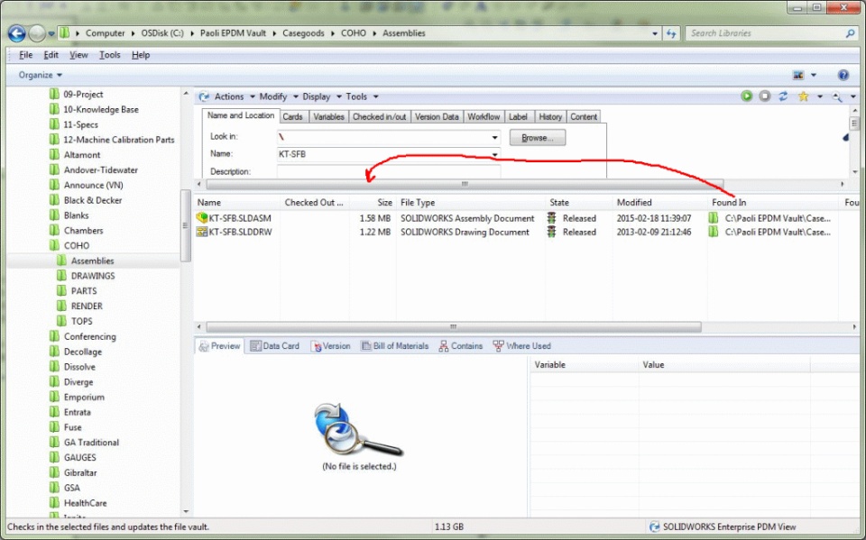

I would like to reorder the columns in the EPDM search results window. I have not been able to find specific help for this question in my forum searches. Anyone know if this can be done and how?  See picture.

the search result columns are set in the admin tool. so you will likely need to talk to your EPDM admin.
SF
SF 2016-01-21
Hello Stephen, you (or your EPDM admin) need to create a column set for Search result defining exactly what columns you want and what order you want them in.
In the EPDM Administration tool:
1. Log into your vault, right-click Columns, New column set
2. Set the column set type to Search result, add the columns you want, and set their order using the up and down buttons
3. Click OK to create the column set. Finally, open up the Search card you normally use to search and assign the column set you just created to the card as below:
