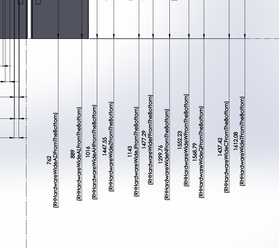

In one of my project I need to rename hundred of dimension name (From RH to LH). Can any one help to rename multiple dimension with the help of macro or any other short process?

Attached are file in which I need to update Dimension Naming in Sketch. In Sketch "RHHardwareWideSketch" I need to rename RH word with LH.
Could you please look into this.

Hi,
Yes, it is working fine for me. Have you tried to select the sketch and run the macro? Please see video attached
