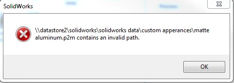

I created a custom appearance for aluminium and put the file on our old server. We recently moved and no longer have that server, but Solidworks keeps giving me an error that says it can't find this custom appearance file (it's the only custom appearance I ever created). Error message is below,
IO've changed the directory in System options to look to a new folder that has that same p2m file in it but it hasn't worked. The error comes up when i try and open certain part files (most of which have never had that appearance assigned to them.
