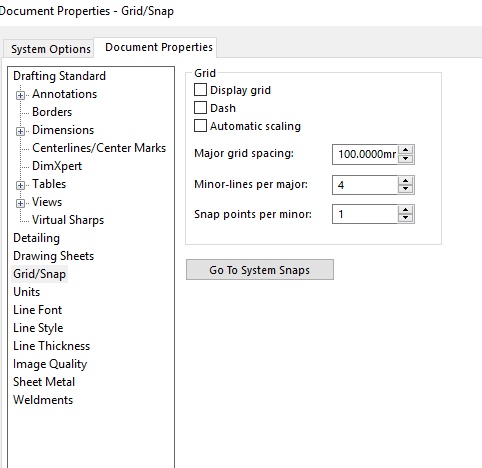

You should be able to turn them off here ... Options/Document Properties/Grid-Snap ... Toggle on/off

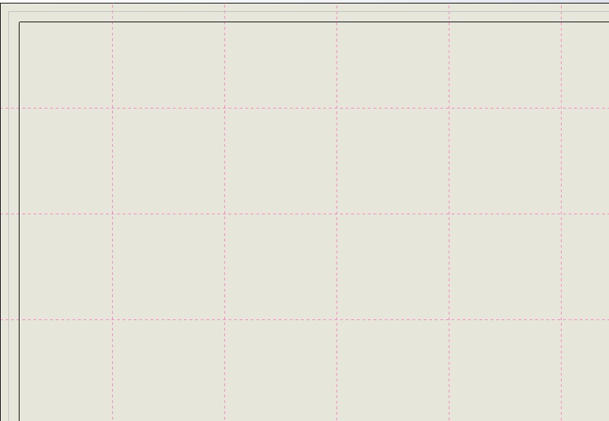

The red grid still appears.

Make sure this is turned off as well, from the settings you showed I am assuming this is the reason why your grid is still showing up.

I agree with Paul that it can be there too ...
It could also be the toggle here, but either of these should still show up when you look at the options if they are on. Makes me think it's coming from somewhere else.

It stills shows. Have also tried to toggle grid on sheet. If enabled a smaller grid with grey lines shows.

View>User Interface>Zone Lines

These are not grid but zone lines. You can set them off under View Menu.
