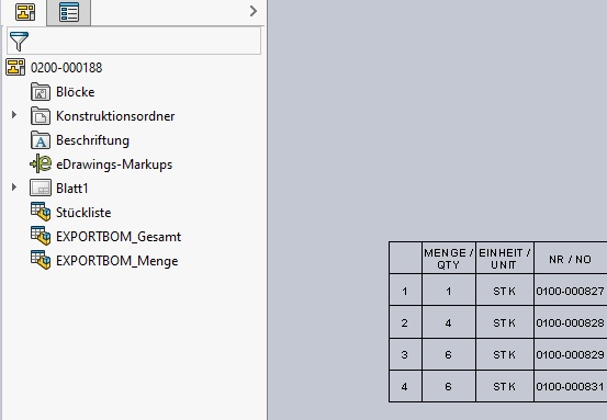

The SW BOM is placed correctly on the drawing but:
The SW BOM is not shown in the feature tree!
Why not?
I tryed to place the SW BOM manually on the drawing, but with the same result.
There must be something wrong in the macro "Delete excel-based BOM" but I can't figure out what.
Manualy deleting the excel-based BOM and inserting the SW BOM via macro works fine.
Technically both macros are working. Only the feature tree does not update.
If I type something in the filterfield above the feature tree and remove the entry from filterfield, suddenly the BOM ist displayed.

End SubI think there is an problem with looping through the features.
Because when I run the macro without any deleting, the feature tree is "frozen" and a new SW BOM will not be shown.

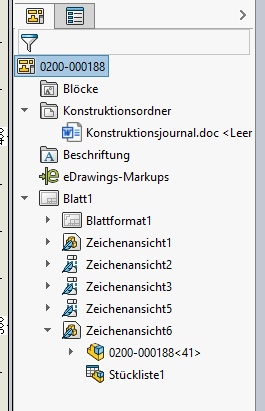

If I expand the view with the excelbased BOM and run the "Delete excel-based BOM" macro, the excel-based BOM is still present.
When I try to select the excel-based BOM, SW crashes.

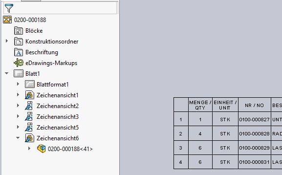

Typing something in the filterfield forces the recalculating of the featuretree and the excel-based BOM entry has vanished.
After running the macro "Insert BOM":
After filtering:
