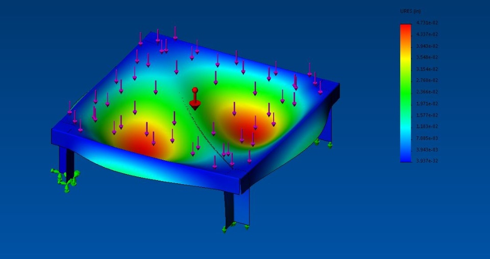

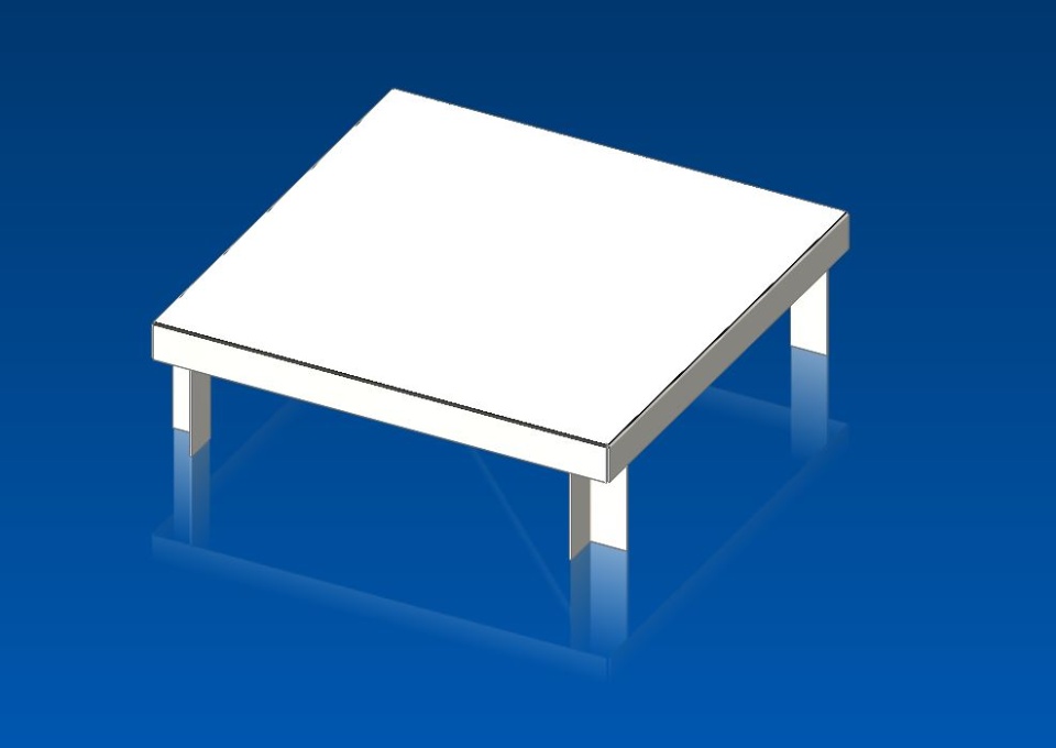

Below is a 36" sq. table made out of sheet metal.  It is to support a crate made of wood or plastic that contains metal parts & weighs 600 lbs.
I applied a force load to the table.  After running the simulation, the stresses are located at expected areas & are low enough that this design would seem to be valid for it's stated purpose.
However, if I look at the displacement, the results look unexpected.  "Large" (.05") bulges appear in the table top.  It's the kind of displacement I would expect in a pressure situation rather than having a semi rigid load placed on top.  Of course the wooden or plastic container itself would deform under load, but I don't see it following the displacement pattern show.
So my questions are:
1) Is there a better way to apply the force to the table so that the displacement would be more true to life (assuming these results are not)?
2) Given that the stresses look fine, do I just ignore the displacement results?
3) And do I trust the stress result given the displacement results doesn't seem true to life?
Appreciate your time.  Attached is the pack-and-go file of the simulation, hope I did it right.  SW 2018

Like you said it should be pressure.
Use area of the table top: 600lbf/area.
Apply the pressure on the table top.

If you want to simulate reality, model reality.
If the real load is applied though a physical object, a magical hand-of-god force will not likely work the same way.
I quickly modeled a simple pallet and applied the force through the pallet. The pallet is in contact with the table top. This separates the boundary condition simplification and the object of interest.
For load support cases I rarely ever use an applied force any more. I model the load and use a gravity vector. Offset loads are easy to do with a mate or dimension (as in this example), dynamics are easy to set up by angling or magnifying the gravity vector, and there's no guesswork and doubt about the setup.
Computer time is increased. Human time is reduced and confidence is increased. Me and my clients have priority in the latter.

Just make a split line of the shape and apply the loads to the perimeter lines is one approach. If you are going to use gravity you need the box structure and put the load on that in a realistic way. Then use contact and solve.

Its because the "box" doesn't flex.  So you don't see the sheet metal flex.
Like I said, add another corner to corner rib under the table top.  It should be strong enough.

So I tried the modeled mass approach.  I made it rigid, removed the global bond, bonded the table & added a no penetration contact.  Used gravity as my only force input.
The results are an extremely stiff table.  Who knows, maybe that's what I got?  But more likely I set up something incorrectly.

Whether or not the stress analysis is incorrect depends on where you're reading the stresses. They're probably correct in the legs, but not matching reality on the face sheet (although not incorrect, just not real yea?).
Bill is spot on. What you've done is basically worst case (worst realistic case at least) for the face sheet. The alternative would be an infinitely stiff box that only applied loads to the frame. So do the worst case for the frame, cut out most of the face sheet (and remember to apply the same load not the same pressure) and do the analysis again e.g.
If stresses are fine for the face sheet in the first scenario (the one you've alread done), and they're fine for the frame in the above scenario, then you're pretty set.

The load distribution will be a function of the box bending stiffness. You approximated it as a evenly distributed load (pressure) - the box has no stiffness. You could easily assume the stiffness of the box is infinite and that the CofG is in the centre and you could distribute the load around the perimeter. If the circumference is not circular you could argue that an evenly distributed line load is not strictly correct but it would likely allow you to bound up the problem as lying between these two cases. Or, if more accuracy is needed model the box with the load and the contact. Since the diagonal beam is stiffer than the sheet it will carry more of load. The load will be distributed in proportion to the stiffness - stiffer structure takes more load.

I applied pressure, .463 psi (600/(36*36)) & the results were similar to the force load.

You may however want to apply the entire max load over one leg though. I don't know about you, but I've stood on a few tables in my lifetime, right on top of only one of the legs, so pretty much all the force is going through that one leg.
Then there's the top surface, again what you've done is a good starting point. However you may want to consider looking at say the heaviest concievable/allowable object/force, and what a realistic area of application could be. Again refering to a person, a person could be 200kg, and then hold 50kg, but only be applying the load in the area of their feet, which is a lot less than a big box. Alternatively a heavy crate/box on some sort of special feet would give the same effect. You may want to consider applying a load, like the person example above, applied in the area your first analysis showed the most deformation.
In swx you can apply to just a specific area by using splitlines to create small sectioned areas where you can apply loads/restraints etc.
Whether it's pressure or force doesn't make a difference, as long as you calculate them out correctly, and you're not getting non-linear effects (I assume your table isn't deforming so much though!).
Then if for some reason the above wasn't giving you realistic enough answers (because you're actually analysing a two tonne Zerodur bed used for microelectronics processing and you care about nanometers right???), you could include an actual dummy object to spread out the load realistically etc, which would also deform, as you mentioned before. But I would start with sectioning off areas of worst deformation and applying loads that way.
