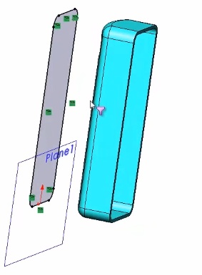

I found this video on: Surface Area Projection
You have to be able to "select edges" and then you can "Convert Entities" and the projected lines etc will go onto the sketch:
Like this:

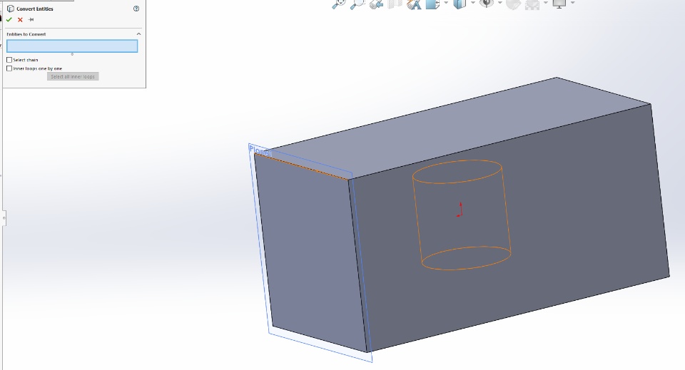

My problem is that hidden geometry that is Inside of a Part, doesn't seem to be able to be selected.
A simple example: is a hollow cylinder in the center of a cube.
I tried to select the surface and convert it using "Convert Entities" but I am unable to select the geometry inside the cube:
My question is basically, how can I project the cylinder, that is hidden, onto the sketch plane?

Ok. I found the answer, hidden geometry can be selected by right mouse click over the geometry in a sketch, and choose "Select Other".
