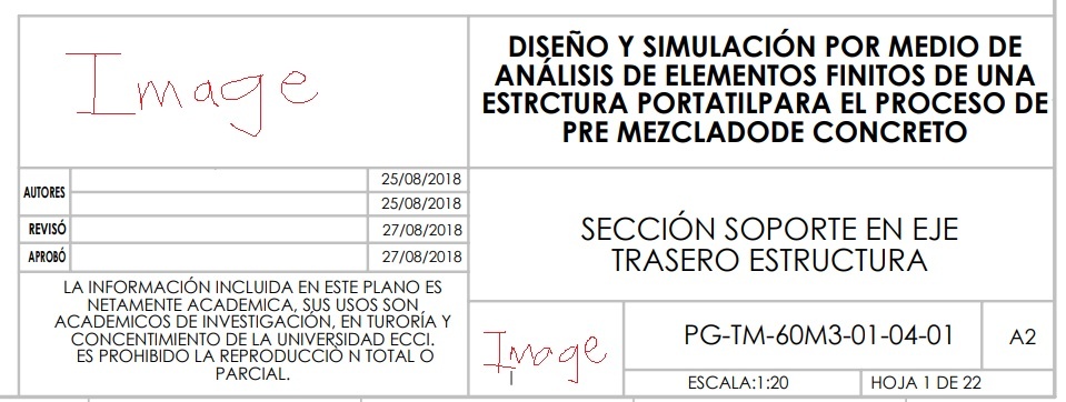

<p>Sadie Kane wrote:</p><p></p><p>I print to pdf some planimetrics, but the logos (image) don't get printed. What can I do?</p><p style="padding: 0px; min-height: 8pt;"></p><p></p>
Do you "print" to a PDF or do you "Save As PDF"?
If you are printing to a PDF printer driver, what is your driver? And have you tried saving as a PDF instead?

<p>Dan Bovinich wrote:</p><p></p><p>what is planimetrics?</p>
As I know it is basically measuring of 2d images and getting area, distance, length, angle, etc. as output.

It could also be something as simple as doing a Ctrl Q rebuild prior to pdf'ing the dwg.

Hello Sadie,
Welcome to the forum. Like , I don't know what you mean by "planimetrics", but I'm going to assume your screenshot is of a title block in a SolidWorks drawing. If that's a valid assumption, then check your settings when printing to pdf, maybe choosing "High Quality Print" instead of "Standard" in the screenshot shown below.
If that doesn't work, I'd suggest trying to save as pdf instead, again checking the settings if you don't get good results the first time.

It works more reliably with less errors. YMMV.
Also, It automatically creates a PDF page size equal to the Drawing Sheet. You don't get misrepresented scales because 1 = 1 .
What is the advantage of this way of working?
Yes.
I advise not Printing to PDF at all, but rather Save_As and choose filetype "Adobe Portable Document Format (*.pdf)".
It is useful and meaningful to explore available Options in the [Options] button which appears below File name: and Save as type: fields only after you have selected your file type.
