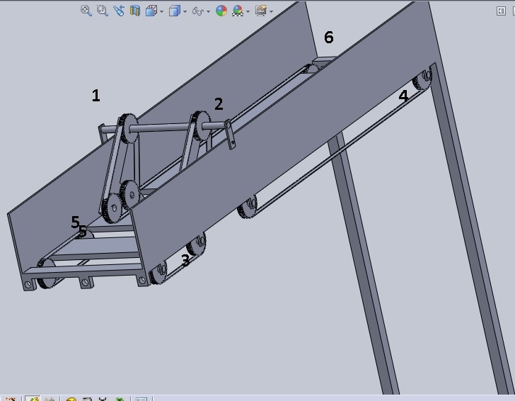

HOW TO PLAY BELT WITH BELT AND CHAIN
I MADE THIS ASSEMBLY IN SW 2013
AND WELL CREATED BUT I NEED TO PLAY BELT ALONG WITH PULLEY
IS IT POSSIBLE
I MEAN TO SAY PULLEYS ON WHICH BELT CREATD IS NOT MOVING ALONG WITH PULLEYS...
I NEED THAT BCZ I WANT TO TEST WETHER A PART WILL MOVE ON THIS OR NOT...

SORRY I WANTED TO SAY THAT PULLEY IS MOVING BUT BELT NOT MOVE ALONG PULLEY

Ankush, the belts are virtual parts and they won't move with pulleys but the pulley which are driven by these belts will move/rotate.

THIS VIDEO HAVE NIT FULL DETAIL FOR HOW TO MAKE CONVEYOR...
SOR DO U HAVE ANY IDEA SO THAT MY BELT WILL ALSO ROTATE WITH PULLEY

You'll have to make the belt via small links in case you want the belt to move along with the pulleys something this: Animated Chain in SolidWorks
