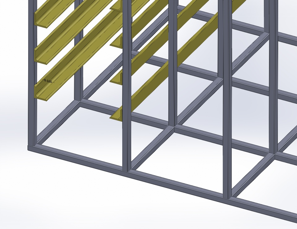

I am working on a rack project, use weldments to create the rack,  I try to use linear pattern on "Structural Members" (see attached, yellow angle), but didn't work.Anybody know can we use pattern feature on weldments? Mirror feature looks like didn't work on weldments too.

Because weldments are composed of non-merging features when creating your pattern, use the body selection box of the linear pattern PMP to choose which bodies to pattern. The same thing applies to mirror features.

Matt is probably right.  When you open the Linear Pattern function, "Features to Pattern" will be open by default.  You need to make your selections in "Bodies to Pattern" instead.  If that isn't your issue, can you post your part?

You are right, can't pattern or mirror non-merging feature, weldments is part but like many parts assemble together, so when start to build model, you have to consider only can use body pattern or mirror, very good, I learn something.

glenn is right use the "bodies to pattern" in the linear pattern feature to pattern weldment parts
