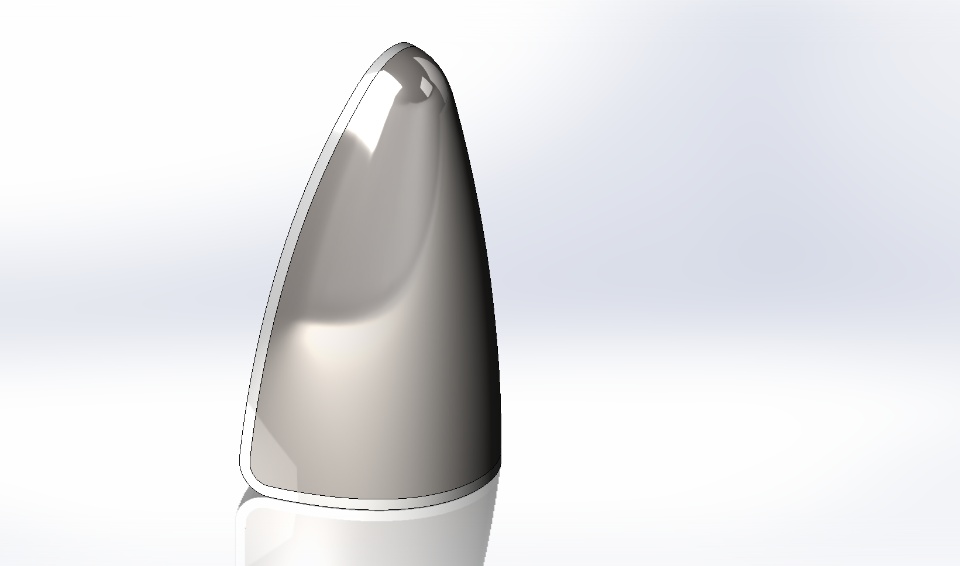

I want to make a solidworks model of the object in the picture (ac1100-4). I tried it with a loft for the basis, but the result is not satisfactory (see other picture). Can anyone help me by giving me some advice on how to build up a model of this object?

You'll want to use lofts or boundary surfaces. You'll also want to use guide curves to get the profiles right. For the top, you should loft to a point, since the top is smooth, rather than the small circle that you created. You may not be able to create the main body in one feature, so don't be afraid to try multiple loft or boundary features to get the desired results. There are also quite a few surfacing tutorials online that would help you out.

Best handled as a surface model - starting with a swept or boundary surface for the front and then creating a sweep for the rear. See attach.
