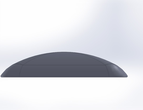

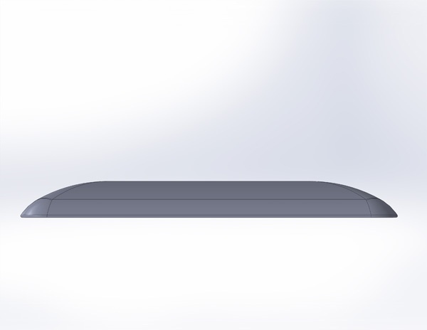

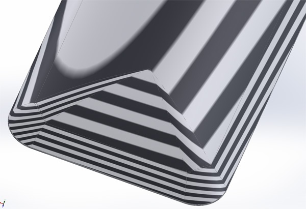

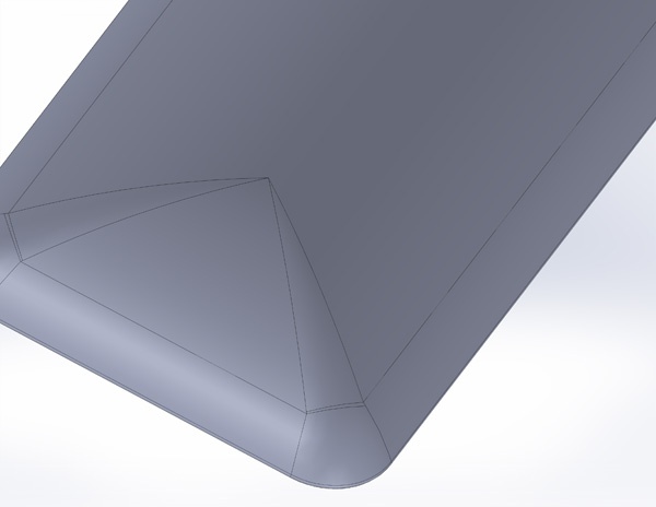

Hi All,
I have been trying to model the back of a new phone case and have tried a multitude of different lofts, cuts, and extrusions.  I've got something that is okay, but not as clean as I want it to be (see the attached zebra stripe image).
There needs to be curvature in both directions when looking at the side of the case (see attached images 2 and 3 below).  Similar to the HTC phone back shown in the image below.  Any tips on how to do this cleanly?

SF 2013-09-11 Best Answer
Aaron,
Boundary and Fill Surfaces are probably your best bet. You might want to move this to the Surfacing Forum, as the folks who can help you the most tend to hang out there.
