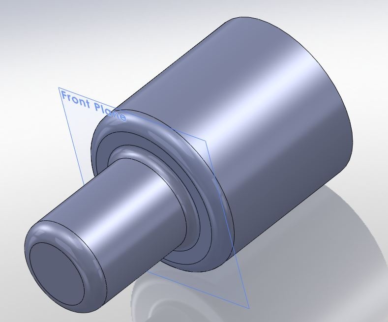

Hi,
I want to add gold plated circuit traces along the surface of the attached plastic part.(The plating will start from the front nose just after the fillet and extend along the surface of the front shaft, then up the wall and along the surface of the larger diamter back shaft.The traces will be a series of narrow traces around the circumference.
What is the best way to do this? The wrap feature does not work for this requirement.

TP 2010-12-08 Best Answer
split the face into traces then change the visual properties of the traces to be gold.

Ok, it took me 20 minutes to find the "split" command. I can't understand what this command is doing and how to use it?
Basically I am looking for a methodology to model traces on the surface of solids with a lot of curves and non-planar surfaces.
Can you please explain in more detail what to do?

This is a possibilty for you. Just and extrude to surface, then a surface offset, then an extrude cut to the surface offset. The surface offset will give you your disired thknss and your original extrude sketch will give you your width and path..

Hi Scott, thanks for your further help. The traces are not always running straight. They can take zigs and zags for example along the length of the part, while still sitting on top of the surface.
The attached un-plated part is an example of a basic shape. Now I want to add plating tracks along the surface, but not linear with the part/axis of the part. the traces mayspiral or wrap around in strange ways. Note this is mportant for plated plastic circuitry and MID.

Here's what I ended up with when I did this for a component we required.  2D traces split line on the plastic faces, changed the color to whatever I needed.

This is what I came up with.  Here is a link that shows you how to use the split line
which is what I did in this part.  Hope it works for you.
http://help.solidworks.com/2010/English/solidworks/sldworks/legacyhelp/sldworks/curves/hidd_dve_pline.htm
To get the colors different is I just held down the ctrl key and selected all of the surfaces that needed to be black
and changed the color appearance.  Same for the traces.

Matt,
To use Split Line, you make a curve or closed curve in a sketch that, when projected, splits a face or multiple faces. It has to split the face(s), so a single line partially across a face won't work. Unfortunately, you can't use multiple closed curves, so it is likely to be pretty tedious to us if you have a lot of traces.
You will probably want to look at using Wrap as well. It wraps around circular or conical faces, which may work better for your part. It also allows you to use multiple closed curves. Unfortunately, it only works on one face at a time.

I may need to use Nick's solution (if I can get it working!) because the gold traces need to have a thickness (although only a few / microns and cross-sectional area in order to compute precious metal consumption.

After Creating your initial extrusion down to the part you need to make your offset surface which will determine your cross sectional thknss. Next create another sketch on top of your extrusion (see below). Selct the face and convert entities. Then extrude cut the sketch you just made and choose "up to surface" and pick your offset surface. This will cut all the excess material away and give you the contour you are looking for.

I would do the following:
1. Sketch the desired geometry of the gold
2. Use the sketch to split line the faces of the pin
3. Offset the surfaces associated with the gold by 0
4. Thicken the surfaces while not merging results.

Whether you use Nick's or Robert's approach, you are likely to end up using a combination of Wrap features and Split Line features.
You can probably estimate the gold by just using the area of the traces, as the sides are going to have a relatively small area, being only microinches deep. Even if you have base Copper and a Nickel barrier layer, you're still probably looking at less than .001" thickness. But perhaps you need the thickness for fit as well. Anyway, good luck! Looks like a fun part.
