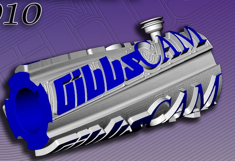

I am looking to make a part with my company logo on it.  It will be stainless or aluminum round.  I was thinking of something similar to this. Some sort of cutting tool with our logo. We are a 60 year old job shop.   How do I go about putting text on a solid like this?

Hi Darin
I have attached a pdf of how I would go about creating a part like this, I have also attached the solidworks part for you to view. Hope this is what you want

Darin,
Another option would be to use the "Wrap" feature - it's going to be more memory intensive, but the "top" of the letters will match the curvature of the part.
Todd
p.s. creating an extrude using "offset from surface" will match the curvature as well . . .

Thanks Paul  & Todd.  I finnaly got the files to download.  Now what way to go with this.  I like both ways. I will send a video when we run this.    Thanks again
