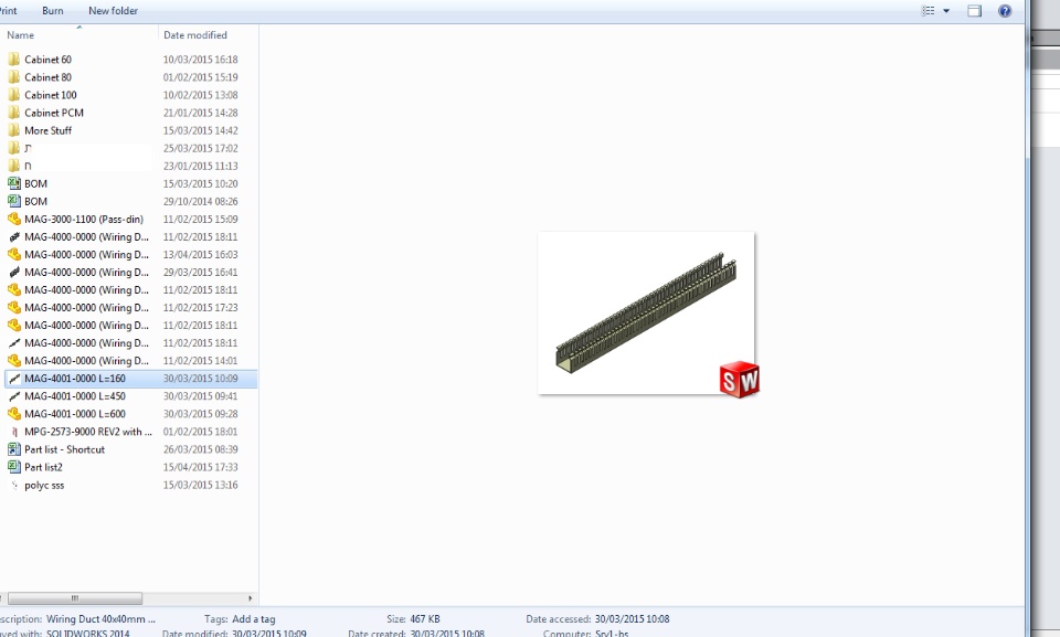

1. I'm having a problem getting the image shown in the preview pane to the fixed size, it used to fit automatically as I changed the size of the preview pane but now it gets as big as it shown bellow no matter how much I move the edge line. it's only in SW files.
This problem began since I upgraded to SW2015. How can I fix this?

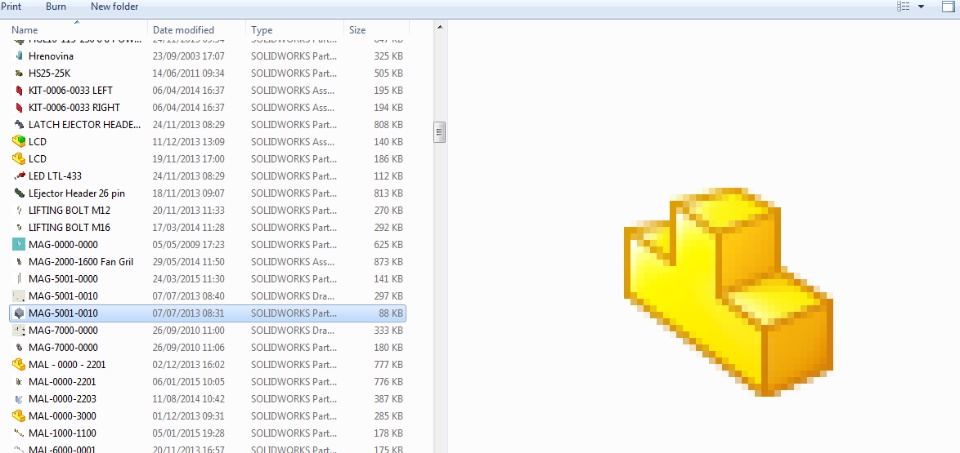

2. Another old problem: sometimes the preview doesn't show to part/assembly. It shows a Solidworks icon instead.

I don't know about the first question, but I had the same issue as in your second question.  I fixed mine by going to Control Panel>System>Advanced System Settings> select the Advanced tab and then settings in the performance section (I'm running Windows 7).  Be sure it is set on "let windows decide what is best".  I had it on custom.  When I changed it to let windows decide, the large SW icons went away.....

Hello Bob,
Thank you for your help, but it didn't solve the problem.
