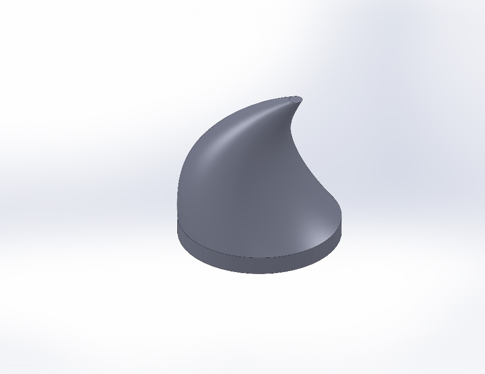

I try to make a loft with sharp end, but it didn't work, I make a small circle instead a point (see attached). Any way can make this Loft with sharp end?

make the second sketch a point - see attached

I tried to use a point on the top plane on a simple case, it works, but for real case, it didn't work (see attached), I don't know why.

here you go
PG
PG 2013-09-06
Thanks Mark
very good, that is I wanted. I tried to add last plane with point, but didn't work, do you complete redo the loft? I still want to figure out why.

Did not do a complete redo on the loft.  Added a sketch with only a sketch point in it where you wanted the loft to end at a point.  Edited the loft and used this sketch as the last profile sketch.
