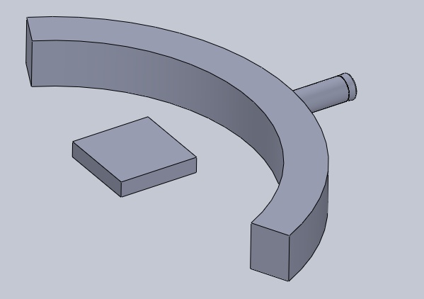

Hi all,
I've been trying to design something like a shower head, where I split a single flow of fluid into many smaller channels.
I've gotten it like this with the curved part all hollowed out on the inside, but I can't seem to place the holes. I've tried using hole wizard but I keep getting an error.
P.s. the rectangular piece is just representative of the workpiece that I want to clean.

Colin,
Try adding a hole on the surface (3D), then use the curve driven pattern and select the hole and the edge of the curve.
Thanks
Mark SolidWorks 2018 sp3

Wrap command.

Hi Maha,
This works! However, I'm having problems controlling the position of the hole properly with this method, how do you do it?
Sadly I can't open your part file as I'm using solidworks 2016.
CN
CN 2018-05-28
Thanks! Both your answers seem to work great for my problem and I've learned a lot thanks to the both of you.
