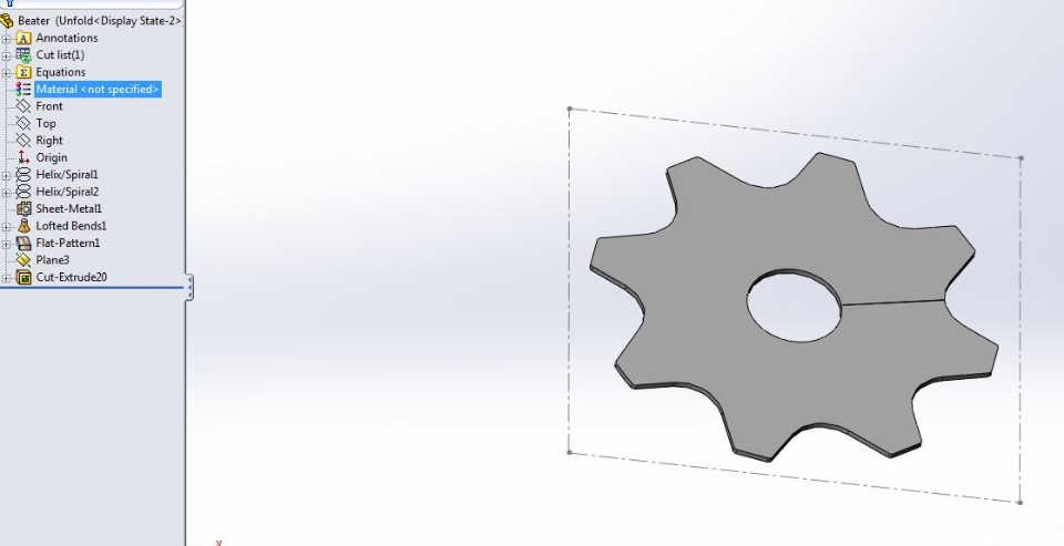

I want this pattern to show just as it looks in the flattened state, in the unflattened state.

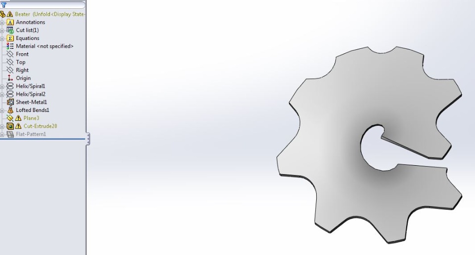

When i re-order the cut to before the flatten in the feature manager then an error occurs.
Any help regarding this would be greatly appreciated.

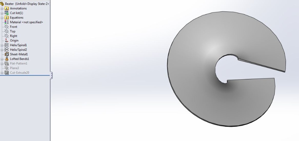

I'm no sheetmetal expert, but IIRC: Try putting in an unbend, then the cut, then a rebend.
MM
MM 2013-08-29
Chris is right. Insert an unfold feature, make your cut, then insert a fold feature that would rebend your part after the cut.
SF
SF 2013-08-29
Thanks guys that worked!
