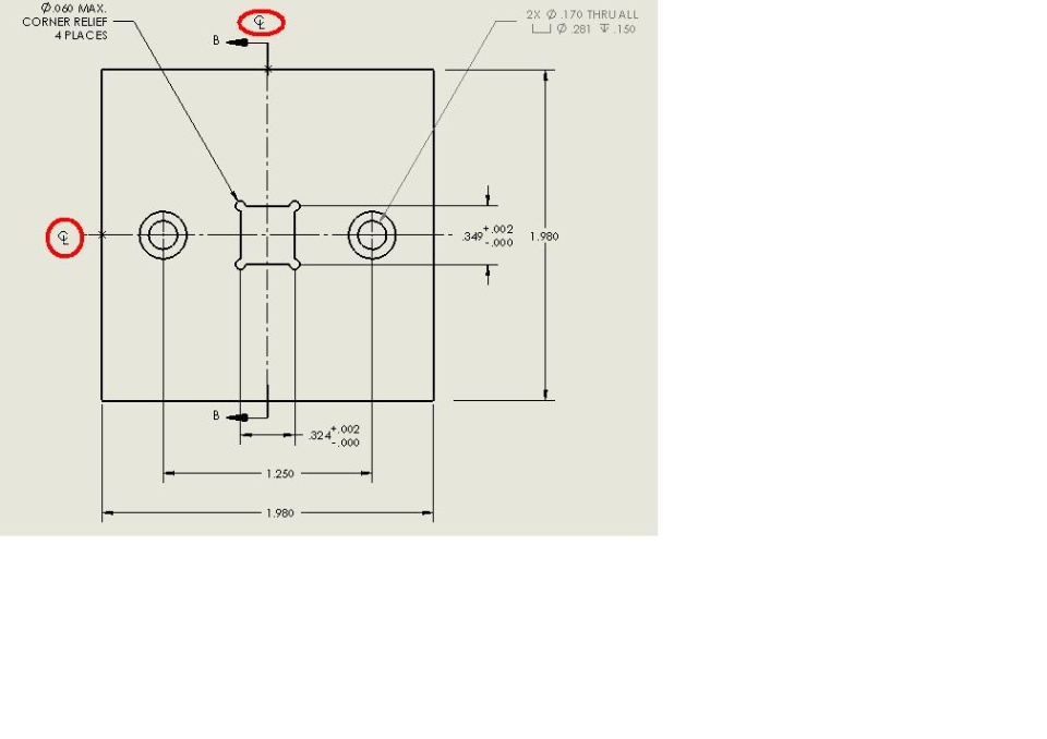

You can pick the outerlines to make the "centerlines" by using annotations command.
Please see the picture.
The symbols were likely not attached to the view. Make sure your view is the active view (locked view focus) to which you wish add the symbols. Then, add your symbols. They will now move with your view. If you do not lock view focus when you add annotation notes (such as the CL symbols), they may not be attached to the view. This is intended behavior.
Thanks Matthew, it works
