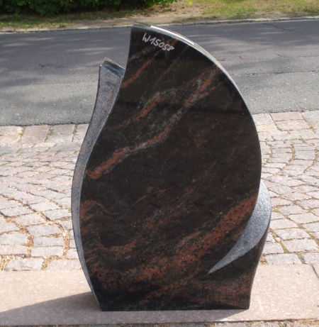

I would like to know what is the best way to make a sort of cut loft around a corner. I tried a few times with 3d sketches and projected lines, but no succes.
The cut I want to draw is in the right bottum corner. It sweeps from the side to the front.
Does anybody know a quick way of doing this and maintain controll on the curvature?

I'vee not opened your file, but if you have the 3d sketches in place to define the edges of the area you wish to remove, use them to create some surfaces then use those to create a split feature on the solid.

I understand, but is there a way to do this without 3d sketches? spline on surface does not work very well I think.

But you should be able to create the 3D curves without drawing on the surfaces, as long as the outer edges extend beyond the boy you wish to cut. You may wish to add some construction geometry to help create the 3D sketches.

Anyone else knows a way to make a cut in this solid without making surfaces? I think of a cut loft or something.
