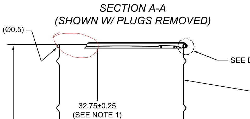

how to make a partial section displaying part of an assembly?
The first one is what I have now in solidworks. The 2nd is the old format in autocad. I want to make that partial of a partial section in soilworks. Is there a way to use different configurations in the same view? or is there something with the section view option I can use?

1. Create one sub-configuration to show this partial section (by assembly features);
2. Use relative view/ model view to show it on the drawing sheet.

I found a way to do it from a new view which allowed me to x ray and section what I wanted to exclude. Thanks!

One more thing, the "2nd is the old format in autocad" is a section view with two levels, that's the main reason I suggested you to use two different configurations to handle it.

  1. be certain the sketch is "in" the section view.
  2. if it is not an alternal position or model break, and it was a newly created section, send it into your VAR - it would appeat to be a BUG.

I am using 2017 and it gives me this.

Okay, I understand now. I didnt know that making features to the whole assembly was possible.I pretty much did the same things as I did with the part file but this time I was able to exclude parts I didnt want to cut. It seems like there isnt an automatic way to do this but it works.

If the section view was created in SW 2014 or later, you most certainly can add a broken out section to a section view. and this can accomplish what you show in your original images.

broken section view does not work on an already sectioned view. if it did it would be perfect for my case. If I do it here to the normal side view it will show an  x ray of what I want but then it wouldnt show the internal features of what should be sectioned like the plugs on the dome shown.

if the section view was created with 2013 or later, you can add a broken out section to the section view - exclude components as needed, and make the depth enough to go al of the way through. no extra configs or files needed.

I thought of that but the top view of what is being sectioned will have partial if that happens. At the moment I have turned the assembly to a part, cut the part in half to make a true section on  and sectioned the top parts that arent needed. So section A-A  is a new inserted drawings with the same dimension features. The only downside to this is that there would be an extra part in the BOM that I will hide and the balloons do not trace back the the individual  respected parts. So I will have to override the balloon numbers.
