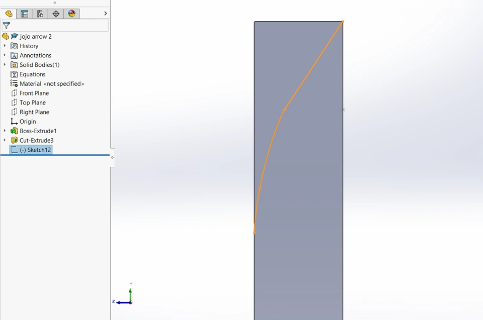

How to make a cut with this sketch?

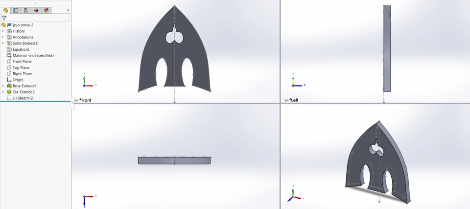

I'm a student working on this as a project for fun, but I can't wrap my head around this. I'm trying to match the shape of this arrowhead from a series I used to read, and I've tried using swept cuts, lofted surfaces, etc, but I couldn't figure it out. I'm just wondering how I can use this sketch to cut along the contour of the arrow, ideally without needing to make a new sketch on every corner. This is just one half of the arrowhead, as I plan on mirroring it afterwards.

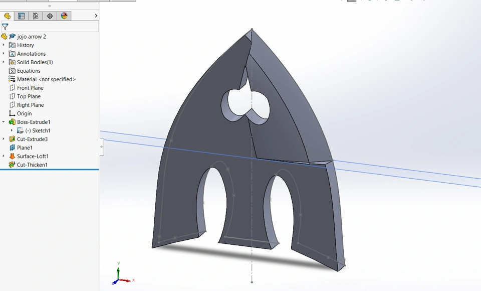

Here is a previous start I had to it, I couldn't figure out how to get a completely straight line down the middle. I used a lofted surface for this.

Whenever you see symmetry, try modeling one half and then when successful, mirror.
The face looks bowed, fattest at the shaft CL, thinning toward the edge. From the bottom of one half, create a a spline or arc to emulate this curvature. At the tip, parallel to the previous sketch, start a new sketch and create the curved entity at this end.
Both sketches are to be closed contours with the contours encompassing the portion to be removed.
Lofted Cut these profile sketches. Then chamfer front and back.
Right of your title, select Edit from the menu and drop in your part file into the OP.

I believe all you need is a couple of Chamfers.
