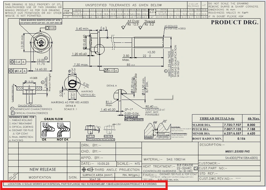

CAN ANYONE TELL HOW TO LINK LOCATION OF THE DRAWINDRAFTING
You can link to different properties using this button as well if you're not sure of the syntax needed
Type this in your note:$PRP:"SW-Folder Name"If you want the file name as well:$PRP:"SW-Folder Name"$PRP:"SW-File Name"
if you dig in here Glenn has some great info.
