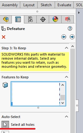

I need to implement application which modify the model via design table and then defeature this assembly.
I have problem with Defeature.
I use SaveDeFeaturedFile() API.
In the objects tree we have Defeature object. When user create it he clicked "All Holes" button on step "Step3: To keep".
In original model there are 4 holes. But when I import design table it can be changed to 5 holes for example.
When I call SaveDeFeaturedFile() API only 4 holes included into result file.
How I can select all holes and include it into Defeature objct using API?
May be I can use another API to control what objects to keep in Defeatured model?
