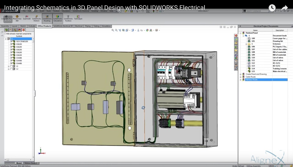

I came across many videos explaining how to route wires/cables/harnesses inside a electrical cabinet and have no trouble understanding them.
An example would be:
Integrating Schematics in 3D Panel Design with SOLIDWORKS Electrical - YouTube
However, I don't understand how there is an electrical cabinet model in the assembly file. Using the above video as an example, the user generated components such as the terminals, PLC, cables, etc, in Solidworks Electrical so that they can be routed. But where does the electrical cabinet come from? Did they just import it into the assembly created by Solidworks Electrical? What is the correct workflow?
