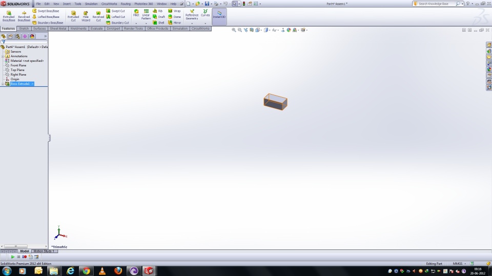

I have an assembly with one part
then I have added new part in the assembly with is created in-context with the assembly.
When I called Componenet2.GetChildren() on the assembly's Component2 pointer, it returned normal as well as in-context part.
Hence I am not able to diffrentiate between normal and In-context part.
