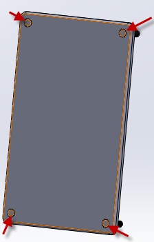

How to hide studs mark?
Whenever I add studs in my part file, they all show the circle mark on the 3D model and the drawing.  Regardless I have  the hole cut out or not the circle mark still show.  Is there a way to hide this?  If I show this plate in Isometric view, the studs has to be visible.  Suppressing the studs is not an option for me.

The studs have a lip on the top which is a bigger diameter that the hole you have cut out, so it generates an interference with the plate- this gives the graphical problem. You may need to create a counterbored holed like the below or locate the stud so the shoulder sits on the face

I 100% support Adam's solution or you can try and move the stud a bit into the model below the surface; 0.01mm will work, but its not a correct solution.

Hi Adam,
Thank you for the suggestion.  I will start using counterbored hole from now on.  I don't know how to determine the size and type of the counterbored hole based on the stud used.  Do you mind showing me please?  Let say I use pem stud FH-M6-25MM for this plate.  This is a default setting when I choose M6.

You can see the value of 14.5 in the image  I would just measure it though and add any clearance you may need.

Here is a good reference for PEM fasteners.  It doesn't mention counterbores, but has some good numbers.
http://www.pemnet.com/fastening_products/pdf/cldata.pdf

Hi Alen,
If I use counterbored hole I can't mate it so that it offset from the surface.  I found a solution for what I am looking for.  I added a very thin extrude on the top face of the plate and it cover that stud circle.  Thank you all for your help.
