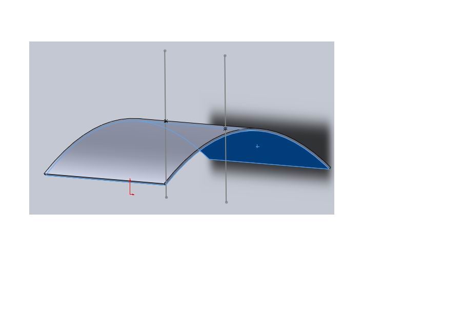

How to get the values of points that are made by intersection between lines and a surface
I wanna use VC to do it,and I have created two lines in space .The problem is that I have no idea how to get the values of the intersected points.
I have looked to  an example using a vector to get points‘ value ,which I find it don't take action here.One more,I have to get the values of points
intersected by the below surface in blue.
I hope you could help me.Thanks in advance.

DY 2012-04-17 Best Answer
Hi
when you touch the point.
you have the values of the point on the left side.
X,Y,Z parameters,
the other option is after creating the point.
add another sketch with all the dimension.
comment imagecomment image

Dor,thanks for your reply.I got your method,however,I wanna make it in API because there will be so many points and I am going to store them.And most important,the points in the upper image are made manually.Do you have any other method?

What I described here is similar to what you will need to do.  You need to programmatically add relations between the point and the surface, and then the point and that line, and then use ISketchPoint::X, Y, and Z to get the coords.

The following steps might help you: -
  • Get Surface object for your Curved Surface. You can use SelectByID2() or some other method to get it.
  • Use ModelDoc2::CreateLine() to get the underlying Curve Object for your line.
  • Use Surface::IntersectCurve2() to get whether the curve intersects the surface or not. This API also returns the intersection point on Surface and on Curve.
