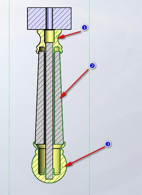

Need to make a cut in component with respect to section view,whether am i correct?

depends where you are trying to do it...
I assume you have an assembly??
simply make a drawing and section the top view???
you could make an assembly configuration that includes a cut from top through all??

Hi, Manikandan.
Thank you for your reply. As you said, I just need to cut some of the components, and then select the cut components in the sectionview. Do you have any good ideas?
Hi, Manikandan.

your pretty much there??
you could try and hide bodies/parts in the section view??
click on the section view, at the bottom of the properties menu is 'more properties' button, you can hide bodies parts etc??
