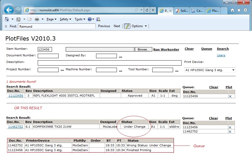

We have made a simple intranet/internet application to plot documents saved in the EPDM vault.
Is it possible to get the previous 'Approved' revision of a document via API?
Code:
        Dim search As IEdmSearch5 = vault.CreateSearch
        search.AddVariable("DocumentNumber", _DocumentNumber)
        search.FileName = "%." & _extension
        Dim result As IEdmSearchResult5 = search.GetFirstResult
        While Not result Is Nothing
            If result.StateName = "Approved" Then
                  'do the plot things
            else
                  'return wrong status to user - no plot done
                  msg = result.StateName
                  'But, I want to plot the previous revision of a document
                  'notify on the plotted document that this document is under change
            end if
