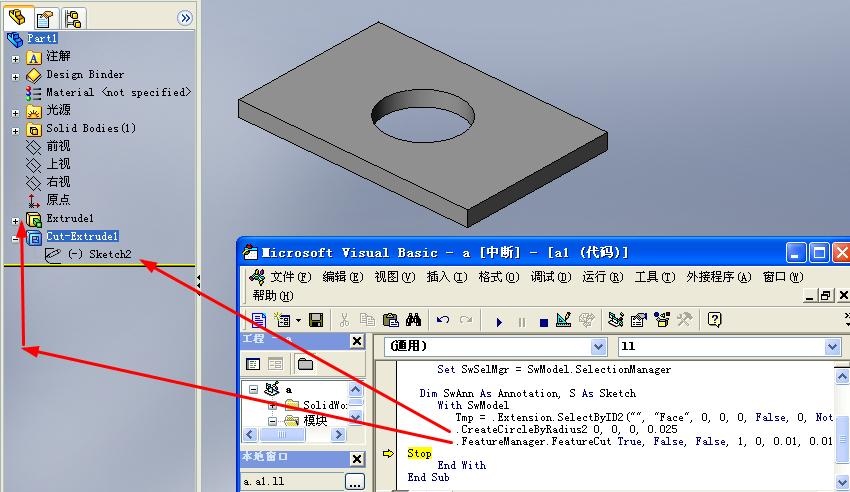

How to get the feature name of Cut-Extrude?
How to obtain sketh name? | SOLIDWORKS Forums
https://forum.solidworks.com/message/339500#339500
Sketch →
        Set SwFeat = .GetActiveSketch
        SwFeat.Select True
        Debug.Print SwFeat.Name
Help me
FeatureManager.FeatureCut → How to get feature name of Cut-Extrude1 name?

SolidworksApi macros
Answers 2
DA
DA 2014-12-09 Best Answer
Try:
<p> Private Sub ll()</p><p>     Dim SwApp As SldWorks.SldWorks, SwModel As ModelDoc2</p><p>     Set SwApp = Application.SldWorks</p><p>     Set SwModel = SwApp.ActiveDoc</p><p>     Dim SwSelMgr As SelectionMgr, Tmp</p><p>     Set SwSelMgr = SwModel.SelectionManager</p><p>     Dim SwAnn As Annotation, S As Sketch</p><p>     <strong>Dim swFeature as Sldworks.Feature</strong></p><p>     Tmp = SwModel.Extension.SelectByID2("", "Face", 0, 0, 0, False, 0, Nothing, 0)</p><p>     SwModel.CreateCircleByRadius2 0, 0, 0, 0.025</p><p><strong>     Set swFeature = SwModel.FeatureManager.FeatureCut3(True, False, False, 1, 0, 0.01, 0.01, False, False, False, False, 0, 0, False, False, False, False, 0, 1, 1, False, False, False, 0, 0, False)</strong></p><p>     debug.print swFeature.Name</p><p>End Sub</p>
FeatureCut is obsolete. Use FeatureCut3 that is available since SW2009 SP4. FeatureCut3 also returns a feature (IFeature interface).
