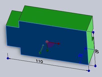

i want to get the center point of the face i have selected, i use the api"GetMassProperties", but it doesn't work and stop in this sentence,"Mass = myNote.GetMassProperties(1)", please help me, thank you!

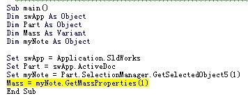

the code:
Sub main()
Dim swApp As Object
Dim Part As Object
Dim myNote As
Dim Mass As Variant
Set Part = swApp.ActiveDoc
Set myNote = Part.SelectionManager.GetSelectedObject5(1)
Mass = myNote.GetMassProperties(1)          'it doesn't work when it runs"
End Sub

Have you checked that the GetSelectedObject5 is actually getting a note. Check that myNote isn't equal to Nothing. If it is you have a problem with your selected object and what it is aquiring.
If the myNote is an object, then take a look how to use GetMassProperties from here http://www.angelsix.com/cms/features/solidworks-macros/42-area-solver
