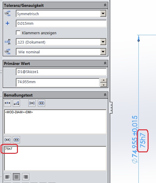

I'm not sure if "2nd dimension text" is the correct term, I mean "75h7" in this picture (red marked):
I tried to use the GetText method but it seems that I can access only the 1st dimension text:
