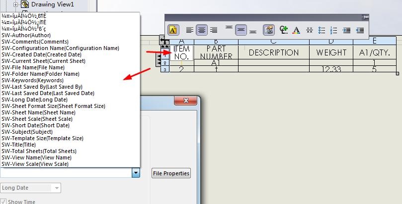

How to get Item No. in BomTable?
Private Sub del20150115()
   Dim SwApp As SldWorks.SldWorks, swModel As ModelDoc2, SwDraw As DrawingDoc
      Set SwApp = Application.SldWorks
      Set swModel = SwApp.ActiveDoc
      swModel.ClearSelection2 True
      Set SwDraw = swModel
   Dim SwFeat As Feature, SwBomFeat As BomFeature
      Set SwFeat = SwDraw.FeatureByName("Bill Of Materials1")
      SwFeat.Select True
      Set SwBomFeat = SwFeat.GetSpecificFeature2
      'Debug.Print SwBomFeat.GetFeature.Name
   Dim SwBomTabAnn As BomTableAnnotation, SwComp As Component2
      Set SwBomTabAnn = SwBomFeat.GetTableAnnotations(0)
      With SwBomTabAnn
         Debug.Print .BomFeature.GetFeature.Name
         Arr = .GetAllCustomProperties
         Set SwComp = .GetComponents(1)(0)
         Debug.Print SwComp.GetModelDoc.GetTitle
         Set SwComp = .GetComponents(2)(0)
         arr1 = .GetColumnCustomProperty(1)
         arr2 = .GetColumnCustomProperty(0)
         For kk = 0 To 10
            Debug.Print kk, .GetColumnUseTitleAsPartNumber(kk),
            Debug.Print .GetColumnCustomProperty(kk)
         Next kk
         Stop
      End With
End Sub
