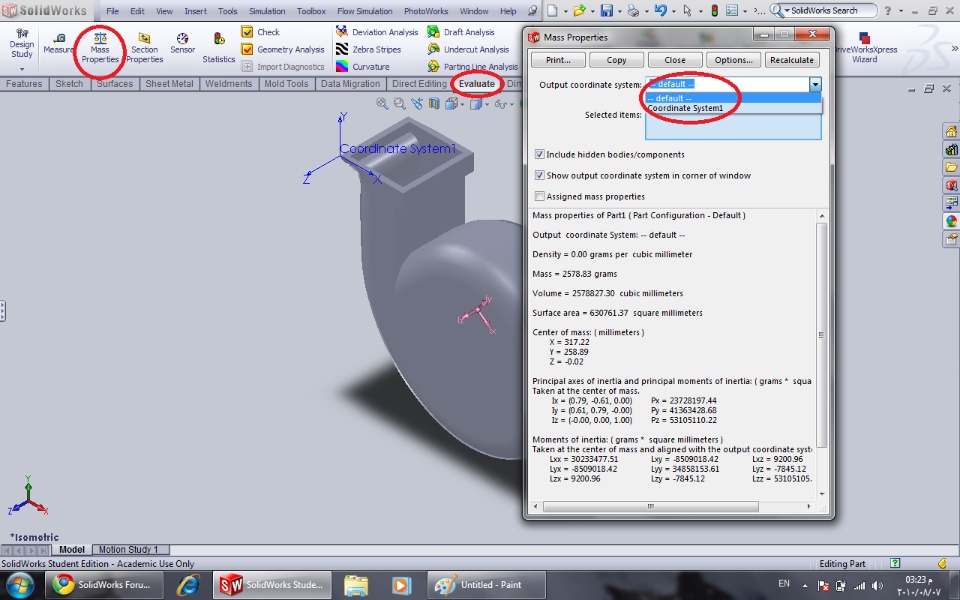

hi,i want to get geometric center of a part in solidworks, how to do it?
is there a api ot a macro that can do it ?

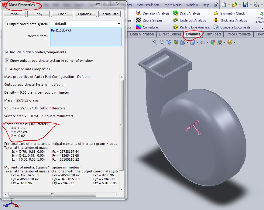

here you go
but sometimes you may have a reference coordinate system so you need to chose it as in the second pic
thank you ,Ahmad Ayesh.
it is a good way to get geometric center of a part in solidworks,but is there any good api or macro to do it?
in solidworks i don't know if there is any other way to do this >>> and i don't know any other program to do this >>> if your looking for accurate; solidworks is the best
