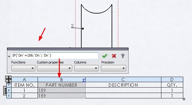

How to get column Equation in BOM
In Solidworks 2012
Help me, How to get equition------IF(`Dn`=159;`Dn`;`Dn`)
follow code, don't find equition?

SolidworksApi macros
Answers 1
MB
MB 2017-08-22 Best Answer
Hi Yong,
Currently there is no API to get the linked equation from table column.
Manikandan
