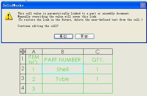

How to get cell parametrically?
This cell value is parametrically linked to a part or assembly document. Manually overriding the value will sever this link.
Help me . get cells link parameter to a part or assembly document.
