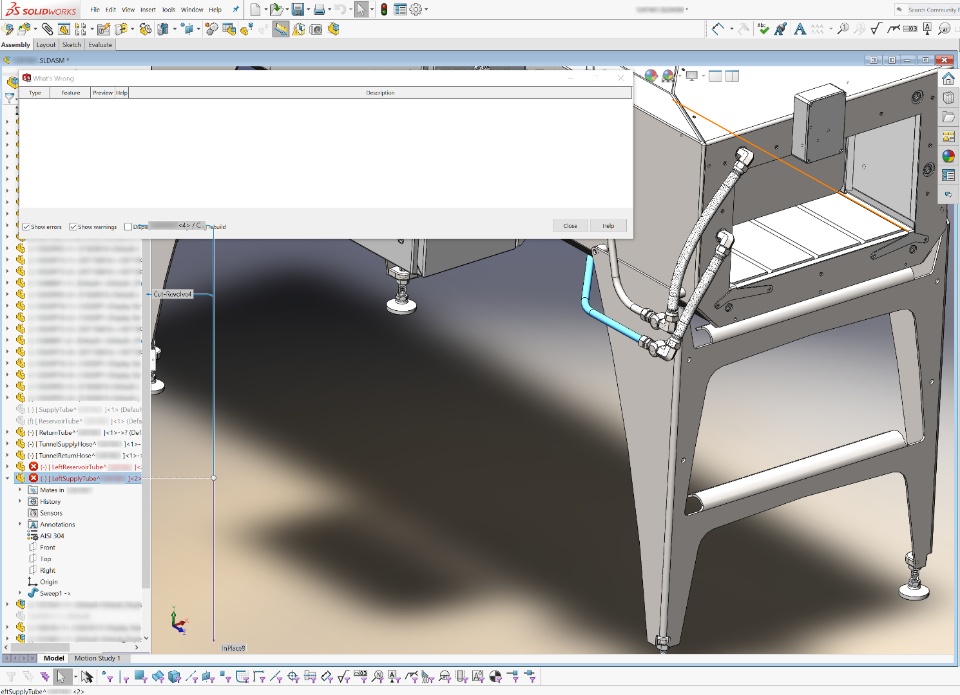

Have an assembly with two configuration, with a couple of virtual parts (tubes) for either configuration.  The tubes suppress or not based on the assembly configuration chosen.  When I choose the left configuration, everything is copacetic except SolidWorks is reporting an error (red colored parts).  When I check what is wrong, no errors...  When I open the parts, no errors...
What do I do with the errors that are not an errors?

It is hard to see in the image posted, but it looks like the highlighted part is made from a single feature, a sweep, and that it is dependent on something external to its own part file.  Is it possible that in the configuration where that part is unsuppressed the feature it is dependent on is suppressed?  Can you just break the dependency of this sweep and make the part stand-alone?

Finding errors when they are elusive is troublesome and for some reason 2016 - 2017 were the best in hiding what is wrong IMO - here is what I do, (and you'll probably be in the same boat),  Edit the part and edit the first feature Sketch and edit the sketch plane, (often times you need to re-select the sketch plane or face) if the sketch plane is ok then you need to edit the sketch and check the sketch relations/sketch entities with the Display/Delete Relations Icon
That is a lot of work if you have a lot of parts, but that would be the first place I'd look, follow the Forest Fire in the Feature Tree and outen the flame one at a time.

yep,..I was trying to find a example of what Bruce is showing... I think it was a in-context relation (a point or eqn?) from a few releases back?

All in the thread above,  I am sure that the problem lies with an assembly constraint in the virtual part.  I am not interested in deleting and rebuilding constraints this way.  Note, that many times, if you have a sweep attached this way (with a concentric line to cylinder), you can later edit the assembly, move one of the anchoring parts, and the sweep will not update.  Not even with ctrl Q.   You need to delete the line to cylinder constraint and recreate it.
Not the case here.  The tubes actually updates quite well in the assembly.
I am sick of spending hours of my day fixing things that were working at some time in the past but now mysteriously break.  Been a problem with Solidworks for 15 years.  Instead, they insist on changing the file structure each major release, forcing their user base to update old parts, assemblies and drawings to work with the latest release.  Every time there are issues like this.

As mentioned above, I typically use a cylinder to line concentric constraint when mating a 3d sketch to existing geometry.  Many times, when you come back later, the constraint will not update.  If you choose to constrain each of the line end points concentrically to the cylinder, it is more robust.  In this case, the constraints are valid, not dangling.  The tubes readjust when I move one of the "anchoring" parts.
