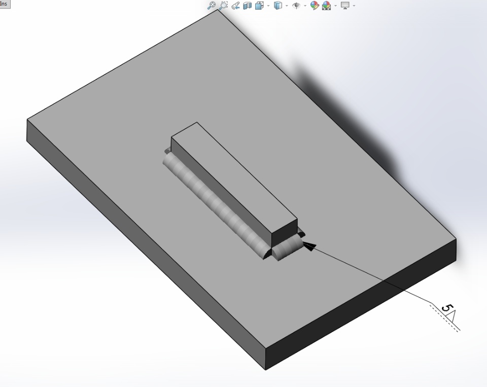

How to fill weld corners?
I have 2 question about weld beads.
First: How i can insert "triangular weld" instead of this "fillet welds"?
Second: How i can fill that weld corners, without making fillets on the "part"?
This image is just an example, i have a much bigger assembly with like 100 parts.
Thanks.
SolidworksWeldments

Luis,,, Can you use the "Fillet Bead" tool?

In parts, yes i can do that.. Inside an assembly, at least i cant. The weldments toolbar moves to the rigth, and on the "Insert" Tab the Weldements-> fillet bead disappear.

In assembly is not possible use Fillet bead. Besides that, using the command Fillet weld is not possible create an weld corner like desired because this command create an graphical weld. It is a simplified representation only.

Yes Luis,, I've never been able to understand why you can't put a fillet bead in an assembly.
The only think I can come up with is to make a couple of configs at the part level. One with bead, one without.  Add a thin dummy plate boss (don't merge) to the bottom of the part that is being welded to the larger part at the assembly level. Then put the fillet bead on it,,, then do a Body-Delete/Keep on the dummy plate.

Just one more question: Is there a possibility to change my symbology? For example, if i want to put the "All Around" symbol

If you click the box marked 'Peripheral' in the Properties screen shown above, your weld symbol will show the little circle to designate the weld as "All Around".
John

I can do that on weal bead, but on Filled bead the box dont let me change anyhting as you can see on the image above

Well,,, that is a heck of a note (heard that somewhere)... Seems like you cannot alter the weld symbol which is included with bead feature. You can go to insert > annotations > weld symbols and insert that and alter it the way you would normally do it in a drawing. I noticed that I had to change the annotation view on the inserted symbol to "Unassigned Items" in order to get the symbol normal to the view. Suppose you would have to delete the other..
