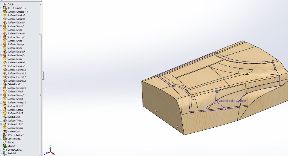

So We make scribe lines on our dies to show where the part is on the die. How do I export it with the line in the 3D sketch shows up I used composite line. But not really sure how to export it right.

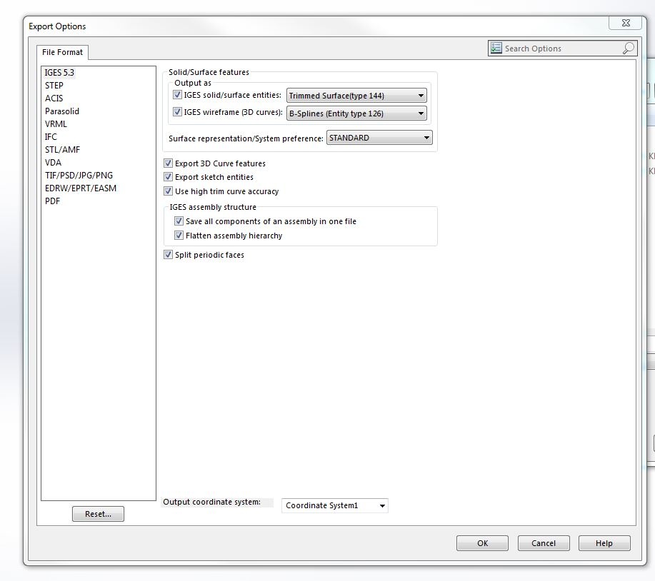

are you wanting just to export the 3D sketch?
exporting to iges?
Do a save as iges....
Yes an iges but I do not just want the sketch I want the sketch and the block.
yes as iges for machining purposes and I need the line to come across on the block as shown.
.....Save as An IGES file and you Get Both - Block and Edge where the sketch is showing
Do a surface offset =0 (Copy surface) of the area covered by the boundary (i.e. a solid boy and a surface body in the part) and export IGS the whole part.
