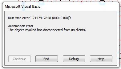

How to end a loop in a macro?
I have merged two macro's together and now it saves all open as a pdf building the file name from values of the referenced model in the drawing file then closes the document.
I am having trouble ending the loop where the macro runs through the drawing and everything I try I get the following error;
I have since deleted anything that trys to end the loop to test the rest of the macro and it works great! It just crashes at the end when there is no open document!
Can someone help me end this loop in the macro?
Your help would be greatly appreciated!!! (see macro below)
