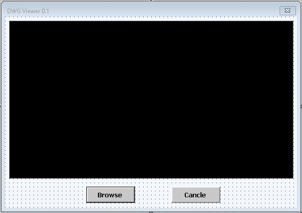

I'm writing a code using VBA editor, the objective is pretty straight i want to create a field within solidworks (so that i don't have to look on both screens to switch between solidworks and eDrawings) in which i can choose my dwg/dxf file and see them while doing my sketching/drawing for reference.
Something like this (This has to be always in front of solidworks interface while it's on.)

With your UserForm active, right click on the controls toolbox and choose Additional Controls...
Select eDrawings 2018 Control (or whatever version you want)
That adds the control to the toolbox.
Click on the icon for it and then drag a rectangle on your user form where you want the control to go.
In the code, possibly in UserForm_Initialize, add a line like this:
EModelViewControl1.OpenDoc "C:\path to your file\Part1.sldprt", False, False, True, ""

Oh! BTW, you've spelt 'Cancel' wrong in your little dialog box..............
