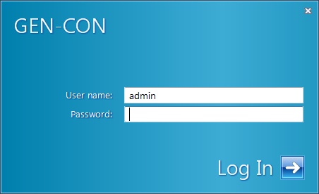

i just want to ask something...if is it possible to edit the Solidworks epdm Log-in window??
has some already tried to edit the log-in window template???
please help me on this matter..
it would be a great help for me if you can send a link or procedure how to edit this thing....
please see attached file
if the attached file is possible to edit....
thank you

What you would like to edit ? the picture?  Name of the vault you are trying to connect ?

hi there Raghavendra bhagwan,,
i just want to edit the picture of the blue plain window...i just want to customized it and put some pictures inside of the log-in window??
is it possible??ive tried to look from the templates inside the administration...but icannot find it...how can i edit or change the log-in window style???can you help me regarding on these matter?
I want to edit the log-in window picture of the EPDM,
is it possible?
thank you

Andrian,
AFAIK, This is a complex change, If i am not wrong you will have to tweak LoginDlg.dll, LoginDlg.e.lan files. You will have to do this on all the client machines. This may pose a challenge when you decide to upgrade to a new version or service pack.
I understand the change is cosmetic, But i would not venture it because of the complexity.
Hope this helps !
